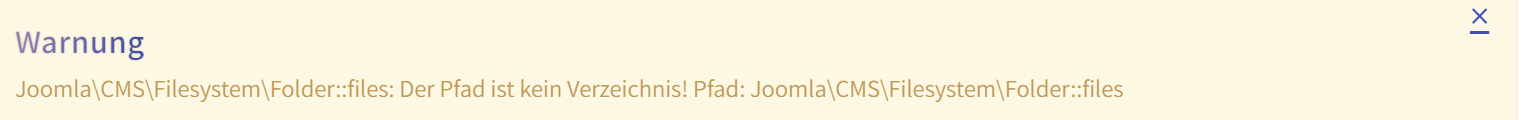

so, with the 2. download i can install Thumbsgallery but i get the following message.
