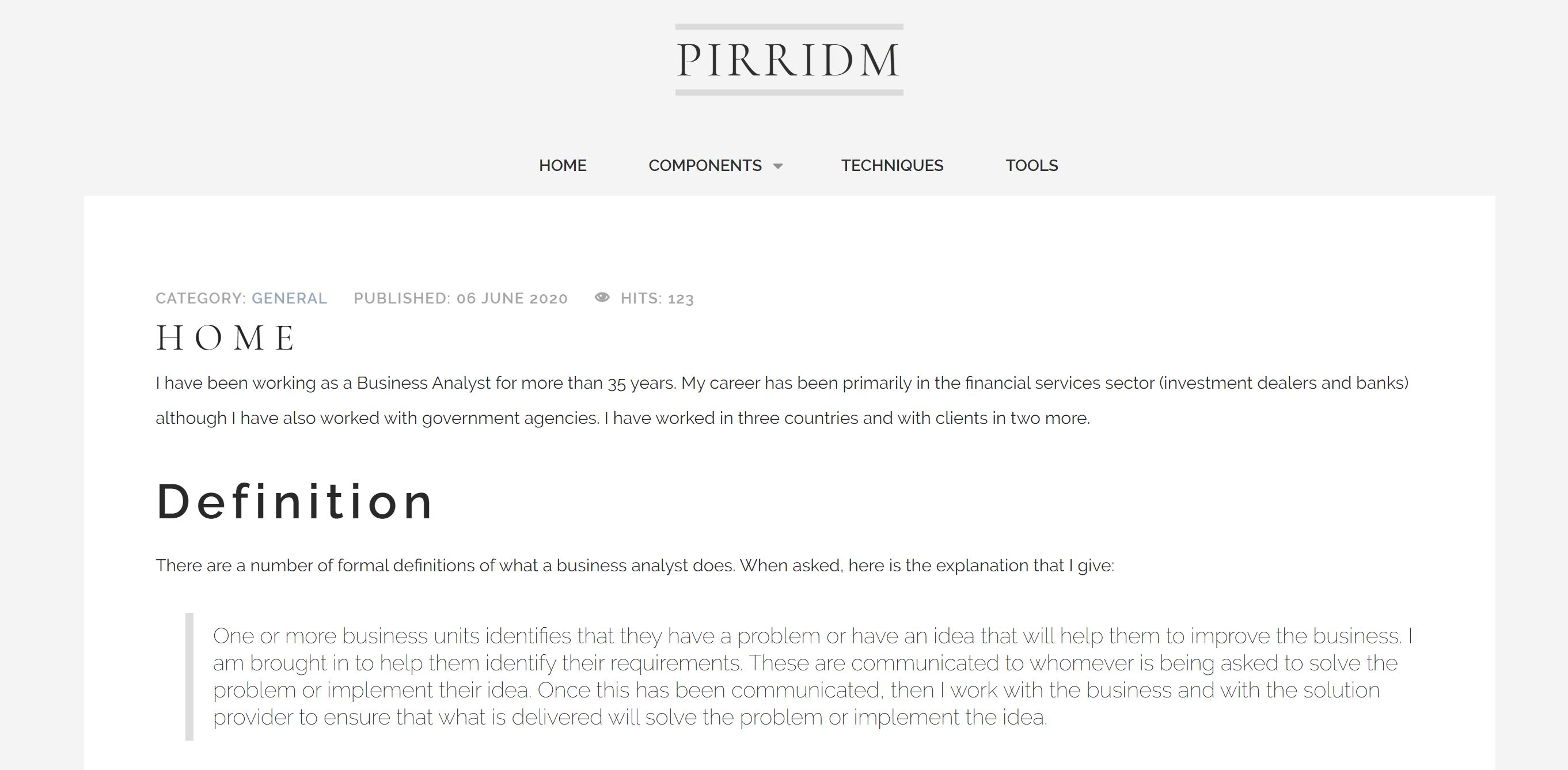

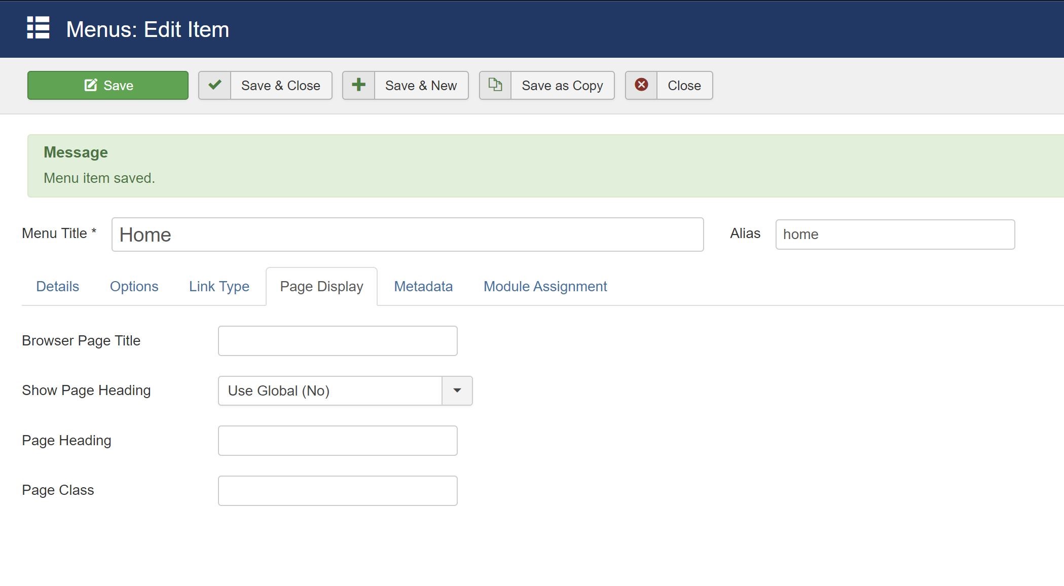

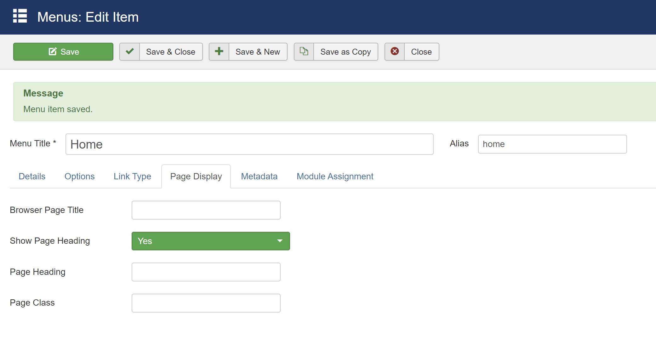

I have solved the first issue (the display of Home on the first page):
[*]Change the setting for Show Page Heading from Yes to No. In my case, the global setting is no, so that is what I chose.
[/list]
That corrected the display of the Home Page - as shown below:

- Go to Menus -> [Your menu name] -> Menu Items.
- Select the Menu Item that is identified as Home (with the star).
- Select the Page Display tab (see Page Display-01)
[/list]

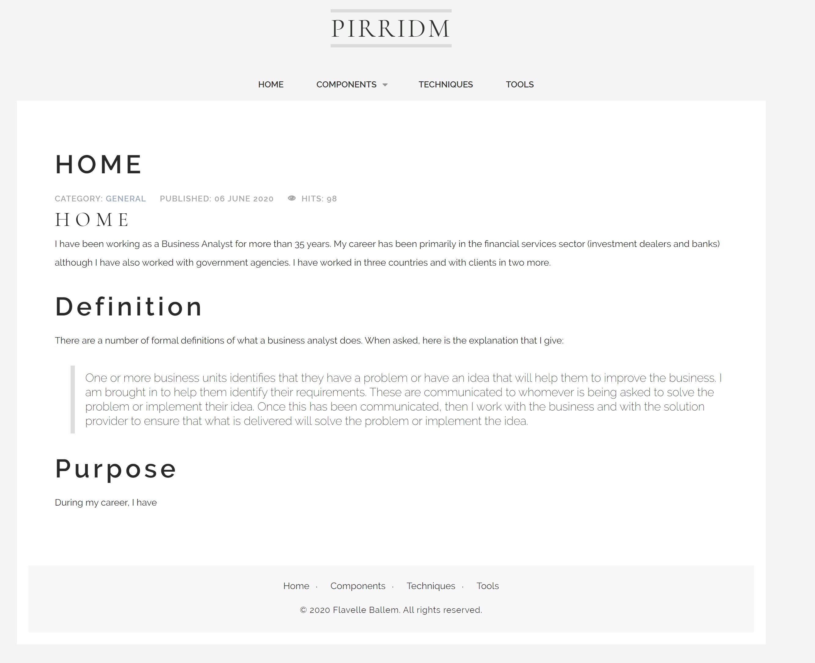

Like the other users here, I have been working with the Kinvara template. I am having two issues that I cannot seem to solve.
I apologise if these are basic questions. I am new to Joomla.
Thanks

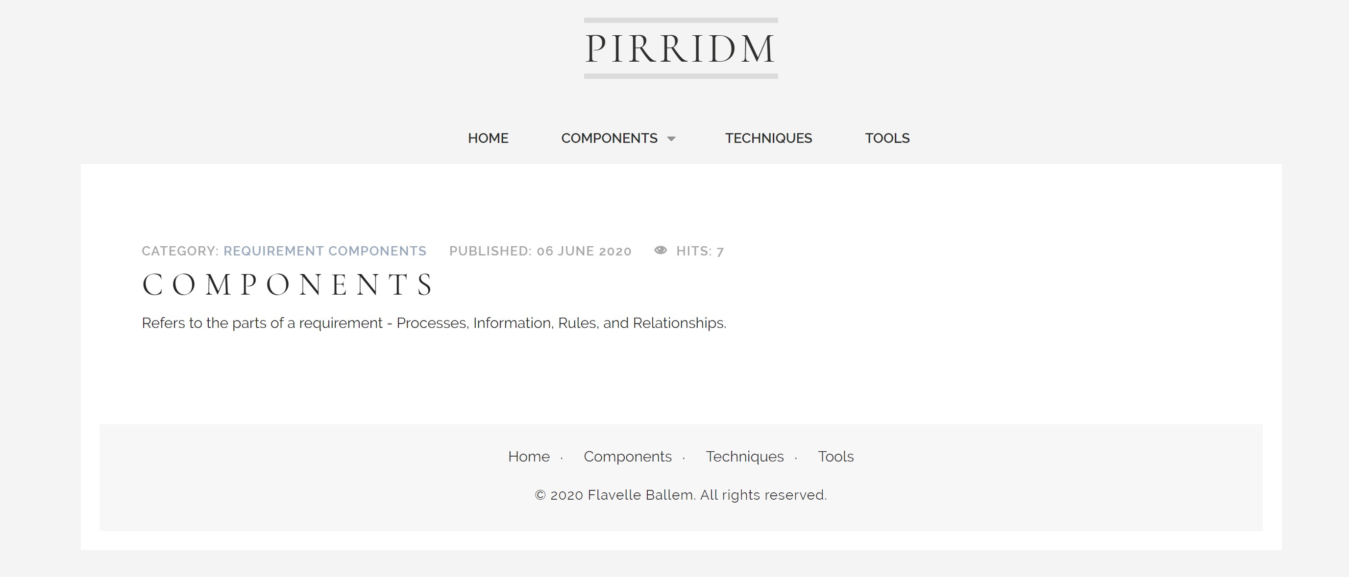

- I have uploaded two screenshots - Home and Components. On the Home page, above the Category, the word, "Home" is displayed in large black letters. On the Components page, there is no similar display of text. There are no other pages with a display of the page name in large black letters. How do I get rid of that display on my home page?
- On all of my pages, there is a menu at the top of each page and at the bottom of each page. How do I get rid of the menu at the bottom of the page?
