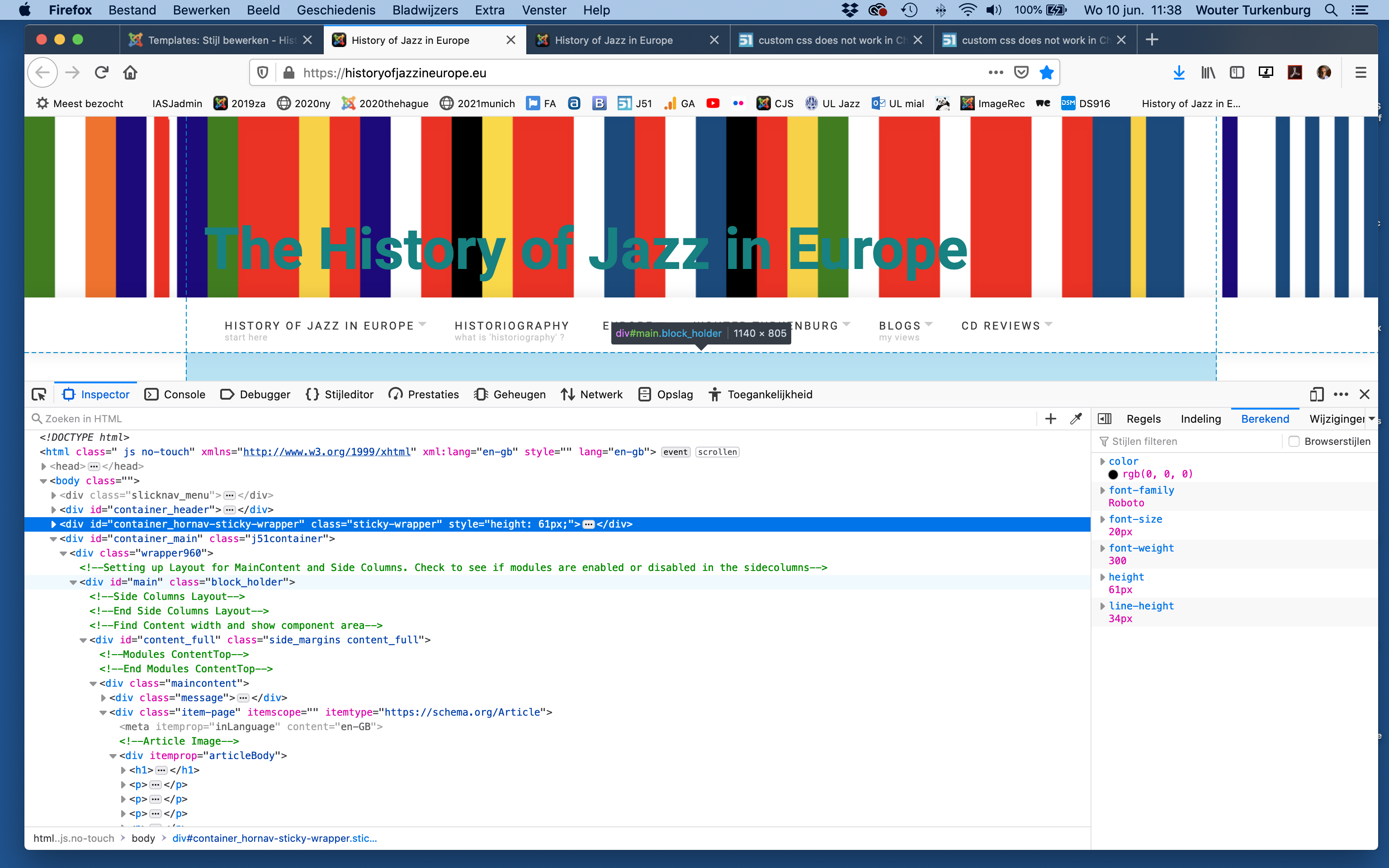

On inspection, I realise your custom CSS is indeed been added without issue. I believe the problem is related to what Geert has mentioned. Each paragraph of text appears to have font-siize: 12pt applied inline to the element which is overriding the CSS in your custom CSS field. This is most likely been applied by your editor. Your editor should allow you to remove the inline sizing and therefore use the size in your custom CSS.

In my inspector I see px and not pt. Are we looking at the same?

When i'm looking on your site with style-editor, I see that the font-size for p is 12pt instead of 12px. Did you perhaps make a typo? Can this be the problem?
Regards, Geert
