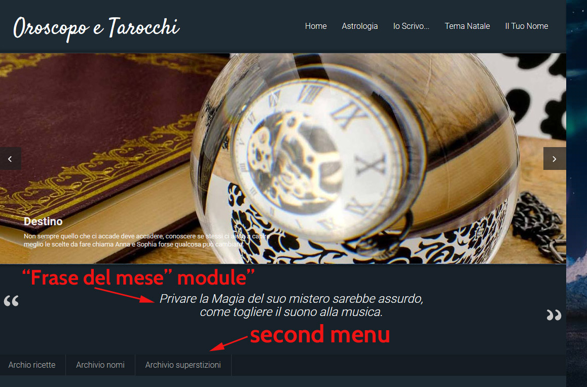

Hi Ciaran,
thank you very much for your reply.
Now the second menu is horizontal now.
I would like to know:
- how can I increase the height of this second menu up to 60 px and keep the links centered vertically;
- how can I place this second menu just below the slide show.

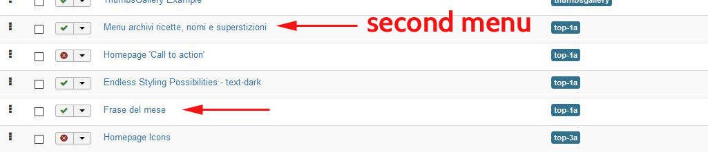

The module of the second menu is placed above the "Sentence of the month" module,
but appears below in the front end. I do not understand why.
See the attachments.
Thank you very much.
Kind regards
Antonietta.

1. To amend replace your CSS with the following (edit to taste)..
2. Try opening the top module (Frase del mese) settings and select the last item in the Ordering dropdown.
.top-1 .menu {
display: flex;
background-color: rgba(0,0,0,.15);
justify-content: center;
.top-1 .menu li {
border-right: 1px solid rgba(255,255,255,.1);
padding: 9px 24px;
.top-1 .menu li:first-of-type {
border-left: 1px solid rgba(255,255,255,.1);
}2. Try opening the top module (Frase del mese) settings and select the last item in the Ordering dropdown.

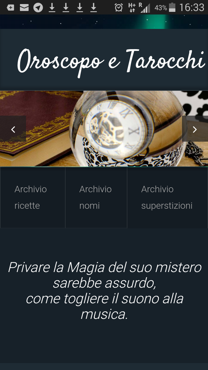

Hi Ciaran,
I saw the web page layout by mobile with Google Chrome. The result is not the best because the second menu isn't responsive.
I don't know what'd happen if I added other menu items.
See the attachment.
Is it possible to improve it in your opinion?

Hi Antonietta
To amend you can try adding the following to the Custom CSS field of your templates parameters (Extensions -> Templates -> [YourTemplateStyle] -> Custom CSS)....
@media only screen and (max-width: 767px) {
.top-1 .menu {
flex-direction: column;
text-align: center;
}Ciaran
