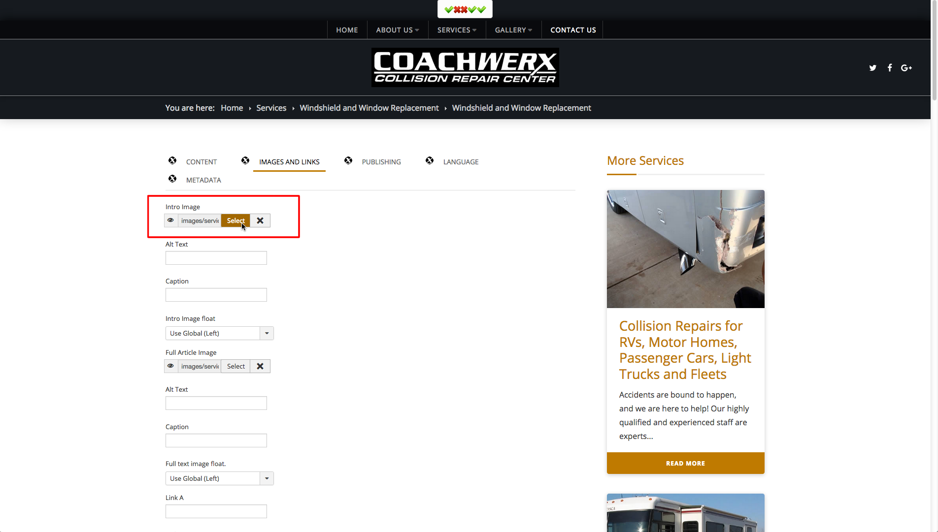

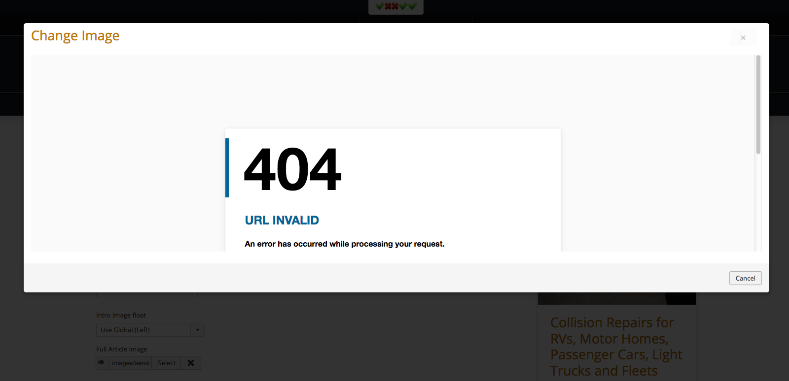

As my title says, when I try to edit an article via the front end, if Search Engine Friendly URLs are enabled (Admin > Global Configuration > SEO Settings) and I try to add an image to the article in the "Images and Links" tab of the editor, the image manager popup shows a 404 error. If I turn SEF URLs off, the image manager works. It matters not which editor I have chosen for the default in Admin > Global Configuration > Default Editor.
Furthermore, if I set a page to use Protostar template I can edit images just fine.
See the attached screen shots below.
Attachments (2)

Hi Vince
On checking your issue we are finding that the issue also occurs with the Protostar template... https://gyazo.com/cb20674a96e2a50f9bd2d43992f87a43 . This would suggest that this is not a template related issue. I would suggest disabling all 3rd party plugins and see if this resolves the issue. Is yes, re-enable each plugin until you find the offending one.
