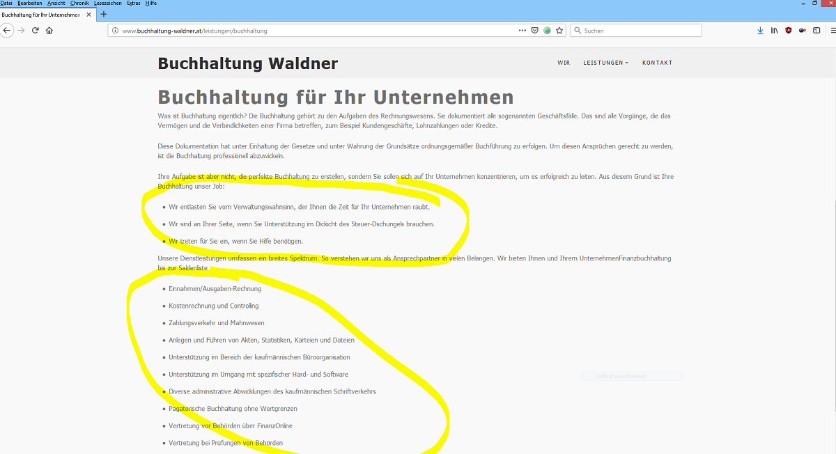

I've checked the list tag ul again in the mobil view. It is still different to the desktop view. Please have a look at this side.
  3. # 5
I am not sure if I understand you correctly. Could you please detail how you find list different.
  3. # 6
I'll post screenshots tonight.
  3. # 7
Looks like the ul tag font in the smartphone view is bolt:
Attachments (2)
  3. # 8
Thank you
li {
    font-weight: 400 !important;
  3. # 9
Problem solved! :)
