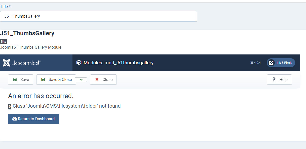

i installed j4 and then installed your new j4 Nina template.... all going well apart from 2 things
1. after installing the J51_ThumbsGallery I got to use it and get,,,,,
An error has occurred.
0 Class 'Joomla\CMS\filesystem\folder' not found
2. the slideshow does not seem to move to the second slide
I know you are super busy but can you please help with this thank you.

I am having the same issue with the Nina J4 thumbsgallery.
I downloaded the latest version and can't do anything with the thumbsgallery, I get "Class 'Joomla\CMS\filesystem\folder' not found" anytime I try to get ner the thumbgallery (editing it, creating a new one...).
I have only installed the latest Nina J4 sample, no other extensions.
Anyway to make it work?

No, i did not get it work.
I don't know where i should Look to find the a solution.
I get the same Massage.
Joomla 4.0.4 and Nina template 1.0.3. I also have Hover extension installed.
Sory, my english is not realy good.

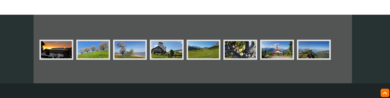

Out of pure curiosity, I had to try this out. I have a page on my localhost that I am working on at the moment. Joomla 4.0.4 / Nina 1.0.3 (yeah, I know, not the latest, but ...). I installed the module and it did not complain. Then I gave a folder some images to eat and configured the module to be displayed in bottom-1a. I can switch between PHP 4.7.25 and 8.0.8 and regardless what PHP version I select, it works.
Sooo I have no idea why it does not work for you. I attach 2 screenshots to prove that I'm not dreaming.

chrishoefliger
After what you said, I tried it locally too with Wampserver and it works with PHP 7.4.0 / 7.4.26 and 8.0.13.
Then, on the online server, I installed Joomla 4, then Nina J4 template, then mod_j51thumbsgallery_j4...and it doesn't work, I get the same error message.
I tried it with PHP 7.4.24 and 8.0.11.
Ciaran, any idea what that could be?
It is getting a bit frustrating to spend so much time trying to make something that should be working...work

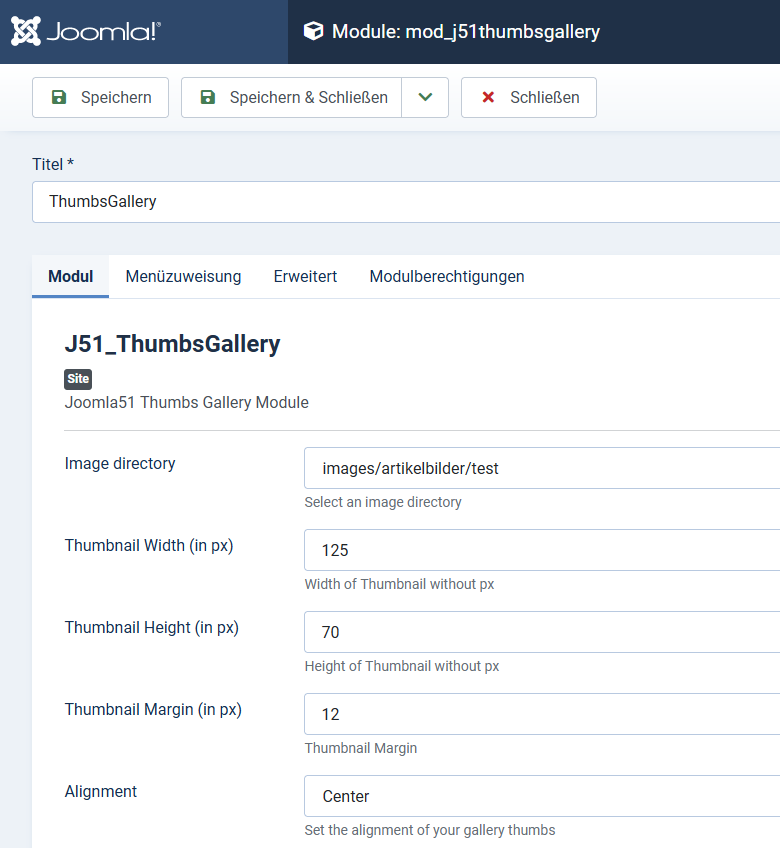

Dear Ciaran,
I have installed the update from https://www.joomla51.com/forum/j4-thumbs-gallery-not-working-correctly-nina-template?start=20#reply-40324 . Now I do not see an error any more. But the gallery is still not shown for me.
I tried it with this modules in the attachements.
This is the url of the test page, where I only see the titles of the modules: https://womostellplatzelche.astrid-guenther.de/

1. To amend try installing the attached update to the THumbsGallery module.
2. May I suggest sending temporary administration access to your Joomla installation to info@joomla51.com and we will examine this issue further. For our reference please paste a link to this post in your email.
