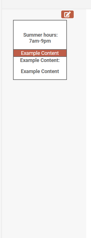

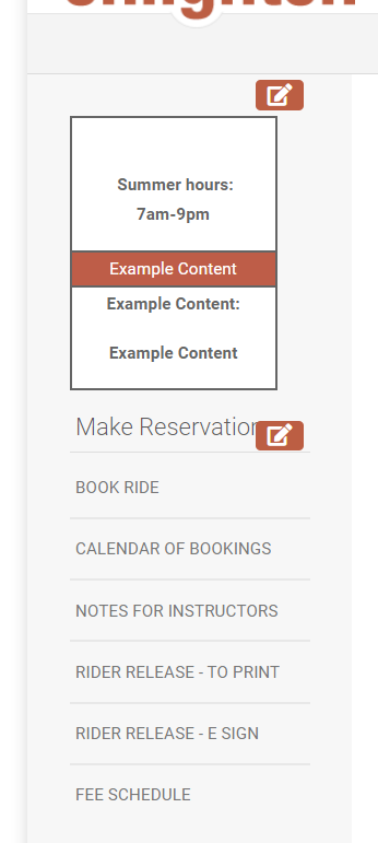

To demonstrate here is a picture of the sidecol_a content with debug mode on
And this is the same content having only turned debug mode off.
As you can see the 'Make Reservations' list disappears and all that's visible is the box of example content.
This same behavior happens anywhere there are collections of module divs and on every page. I've looked through the document structure and class names and they are identical in both versions. I'm sure that I could find a custom css line to put in that would fix this problem but that doesn't seem like how it should be fixed. Any suggestions?
