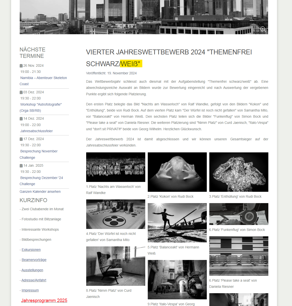

wie use Ashley for Joomla 4 and in the Title the "ß" will be convertet into "ss". In the Text it is fine (see screenshot).
Is there any setting I have missed?
Best regards
Ralf
It is possible that this character is not available with the selected font. Would you have a URL to an example of the issue?
Hello,
yes I do have a URL, but the font for the title is the same as the font for the text (both Arial).
I have attached a screenshot with the original text in the editor backend.
Best regards

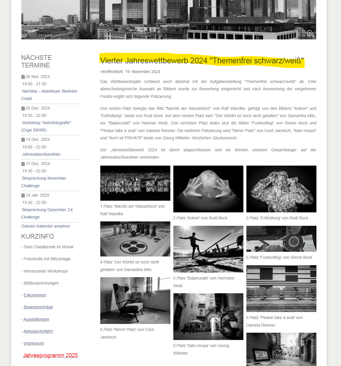

.item-title, .page-header {
text-transform: none;
  3. # 3
Hello,
thank you very much for the tip, so it works, even if the text appears in upper and lower case.
From what I have read, there is probably no capital ß in CCS and that is why it is converted to ss. If I enter a capital ß in in the title, an capital ß comes out, but it looks a bit strange.
For me the solution with the code is ok for now. Thanks again and best regards
